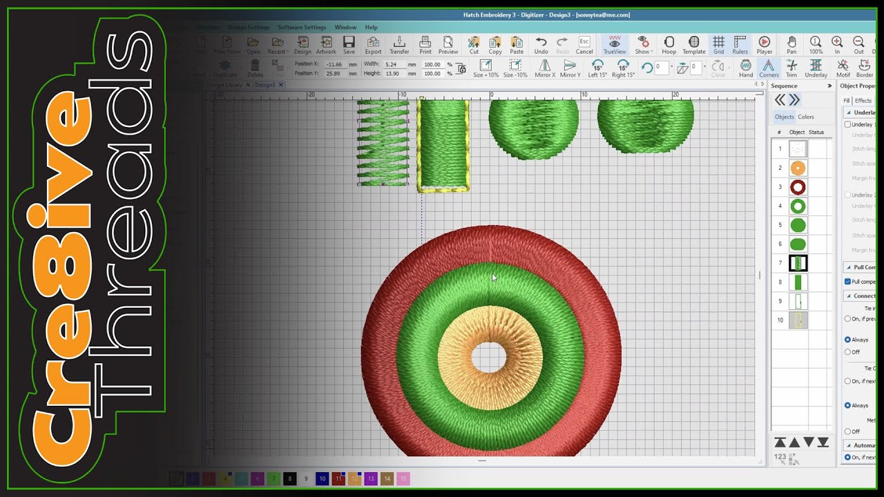

    What is Push and Pull Compensation in Embroidery - Hatch 3 Tutotrial #12
    What is the push and pull all about in Embroidery and how do I deal with it? Im this video Im going to show you what the push and pull is and how to compensa...
